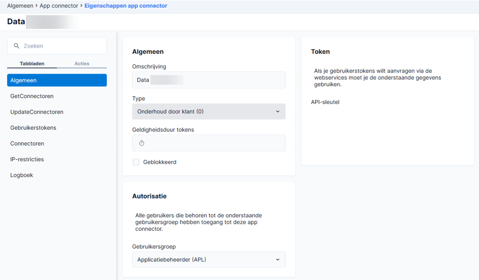

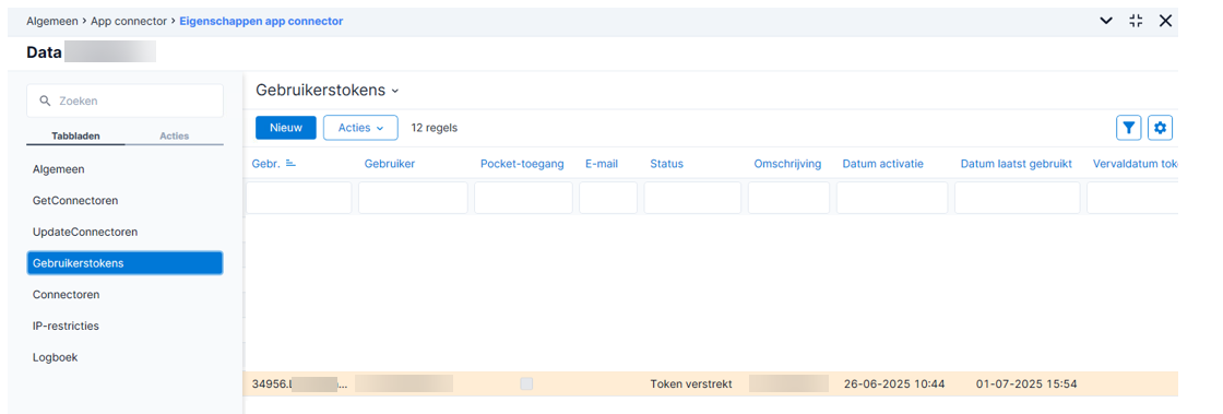

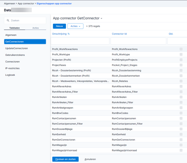

I’ve configured a connector in Afas with the following setup in AFAS:
General
Get Connectors
User Token
So defined the GetConnectors and added myself as a user and there are no IP restrictions setup yet.

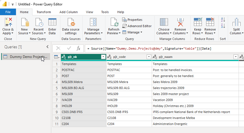

Any existing report will suffice that links to any Invantive database on Invantive Cloud. The Power Query editor should be like:
let
    Source = OData.Feed("https://bridge-online.invantive.com/acme-dummy/odata4", null, [Implementation="2.0"]),
    #"Dummy.Demo.Projects@dmy_table" = Source{[Name="Dummy.Demo.Projects@dmy",Signature="table"]}[Data]
in
Note the additional step which filters source for the table name.
Result:
