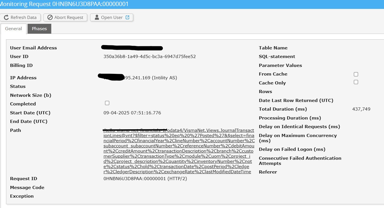

See attached screenshot.
But as you can see the Visma JournalTransactionLines view never completes. It just goes on and on, with the message “waiting for bridge online cloud”. The refresh preview of 1000 rows works fine. However I am not able to load the entire data set.
I am also reauthorized the database container, so that shouldnt be an issue.
Can we talk about this over Teams? I have struggled for some days now, and I urgently need to complete our financial reporting.
Request: 0HNBN6U3D8PAA:00000001
Duration: 437,749
URL: https://bridge-online.cloud/db/odata4/VismaNet.Views.JournalTransactionLines@vnt$filter=status eq 'Posted'&$select=...

Thanks for the information. The messages here are from Power BI and do not provide any context or information. An analysis will be done regarding the request from the picture and then added.
Analysis
  • Request start: 2025-04-09T07:51:16.777034Z
  • Request end: 2025-04-09T08:00:07.6240262Z
  • Error code: itgenboe161
  • Error text: The data download was cancelled after 8 minutes, 50 seconds, such as by the user navigating away in the Power BI or Power Query user interface. Please optimize your query as described on https://go.invantive.com/en/power-bi-tuning. Then re-run the query.
In the tab Phases on Invantive Bridge Online Monitoring the following will be visible:
Could not acquire free slot on throttle ‘ThrottlingBasedOnLicense’ for cap group ‘lic:L979259370’ after waiting since 04/09/2025 07:51:16.
or
Other requests are currently taking up all available slots on the subscription. Wait till another request finishes, optimize your requests or upgrade the subscription. There are 4 requests waiting to be served.
The requests have all gone from memory by now. This problem might be related to a problem itgentmm007, but that can not be established at the moment.
It is recommended to retry the download. When it fails or succeeds, please update this topic.
