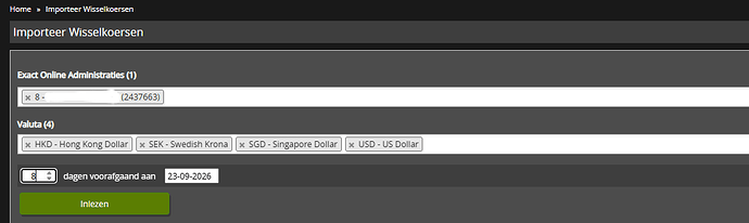

As in the image, I select the leading administration and add the currencies. On my side everything appears to be as normal. The team working in Exact report that, when they look up the currencies overview in any of our administrations, they don’t see any new data past August 31.

In the screenshot, only one ledger is visible, whereas the text refers to multiple ledgers.
