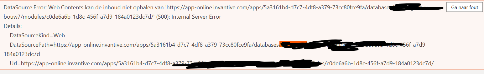

Als ik de module uitvoer in Invantive wordt er wel data teruggeven, alleen op het moment dat ik open in Power BI dan de volgende melding:
Advies is om de versies te vergelijken. Waarschijnlijk draait Invantive Cloud momenteel een nieuwere versie dan Invantive Bridge Online.

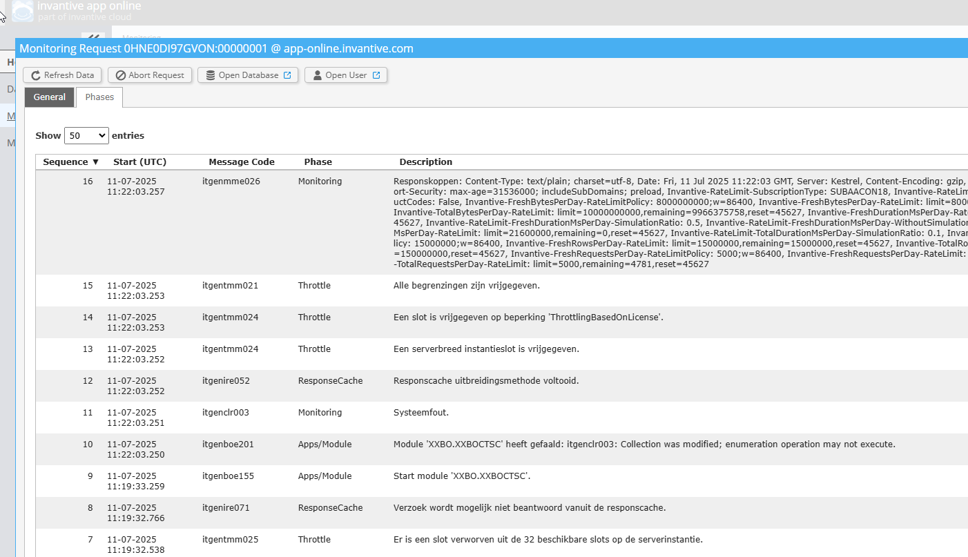

De achterliggende foutmelding treedt alleen bij gelijktijdig ophalen vanuit Power BI van meerdere applicaties. In Systeemmelding en in Monitoring zie ik staan:
itgenclr003
Collection was modified; enumeration operation may not execute.
Er is een onbekende fout opgetreden.
bij de insert op Bouw7.Native.NATIVEPLATFORMSCALARREQUESTS.
Fases:
De call stack is:
System.InvalidOperationException                                                                                                  at System.Collections.Generic.List`1.Enumerator.MoveNext()
   at Invantive.Data.GenericProvider.AddNativePlatformRequestsRows(GlobalState owner, ExecutionOptions executionOptions, IProviderManager manager, ConcurrentBag`1 data)                                                 at Invantive.Data.Providers.OData.ODataProvider.FetchYieldUnfilteredInternal(GlobalState owner, ExecutionOptions executionOptions, SqlExecutionStep sqlExecutionStep, EntityFieldCollection entityFields, QueryObject queryObject, ParameterList parameters, Boolean fetchSingle, Boolean fetchCountFirst, Int32 pagingSteps, Boolean fetchCount)
   at Invantive.Data.GenericProvider.FetchYieldUnfiltered(GlobalState owner, ExecutionOptions executionOptions, SqlExecutionStep sqlExecutionStep, EntityFieldCollection entityFields, QueryObject queryObject, ParameterList parameters, Boolean fetchSingle, Boolean fetchCountFirst, Int32 pagingSteps, Boolean fetchCount)                                                                                                                 at Invantive.Sql.V1.DataSourceOrFunctionWithRotatorTree.GetDataEnumerator(GlobalState owner, ExecutionOptions executionOptions, SqlExecutionStep sqlExecutionStep, QueryObject queryObject, ParameterList parameters)+MoveNext()                                                                                                                                                                                                            at Invantive.Data.CompressedEnumerable`1.GetEnumerator()+MoveNext()                                                                                                                                                   at Invantive.Sql.V1.FirehoseResultSet.Iterator(GlobalState owner, ExecutionOptions executionOptions, IQueryStatePerExecution queryStatePerExecution, SqlExecutionStep parentStep, ISparseArray outerRow, ISparseArray pSqlVariableRow, DatabaseColumnDefinitionCollection oldNewTriggerFields, ISparseArray oldTriggerRow, ISparseArray newTriggerRow, DatabaseColumnDefinitionCollection sourceTriggerFields, ISparseArray sourceTriggerRow)+MoveNext()                                                                                                                                                                                                          at Invantive.Sql.V1.FirehoseResultSet.GetDataEnumerator(GlobalState owner, ExecutionOptions executionOptions, IQueryStatePerExecution queryStatePerExecution, SqlExecutionStep parentStep, ISparseArray outerRow, ISparseArray pSqlVariableRow, DatabaseColumnDefinitionCollection oldNewTriggerFields, ISparseArray oldTriggerRow, ISparseArray newTriggerRow, DatabaseColumnDefinitionCollection sourceTriggerFields, ISparseArray sourceTriggerRow)+MoveNext()                                                                                                                                                                                                 at Invantive.Data.CompressedEnumerable`1.GetEnumerator()+MoveNext()
   at Invantive.Sql.V1.FirehoseResultSet.GetDataEnumerator(GlobalState owner, ExecutionOptions executionOptions, IQueryStatePerExecution queryStatePerExecution, SqlExecutionStep parentStep, ISparseArray outerRow, ISparseArray pSqlVariableRow, DatabaseColumnDefinitionCollection oldNewTriggerFields, ISparseArray oldTriggerRow, ISparseArray newTriggerRow, DatabaseColumnDefinitionCollection sourceTriggerFields, ISparseArray sourceTriggerRow)+MoveNext()   at Invantive.Data.ExtensionMethods.IteratorWithFinally`1.IteratorWithFinallyEnumerator.MoveNext()   at Invantive.Data.ExtensionMethods.CacheFirstEnumerable`1.FetchFirst(GlobalState owner, ExecutionOptions executionOptions)
Het probleem treedt zowel bij het gelijktijdig schrijven als het enerzijds schrijven en anderzijds gelijktijdig lezen op.
Een uitbreiding is doorgevoerd waardoor het mogelijk wordt om gelijktijdig via meerdere applicatiemodule uitvoeringen te lezen en te schrijven in NativePlatformScalarRequests.
Deze uitbreiding is inmiddels als versie 24.0.750 in productie genomen op Invantive Cloud.
Het blijft niet mogelijk om meerdere gelijknamige tabellen in de in-memory driver (...@InMemoryStorage) te maken en te gebruiken vanuit meerdere gelijktijdige applicatiemodule uitvoeringen. De ontwikkelaar dient hier nog steeds zelf locking voor te verzorgen.
