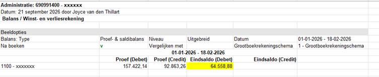

In the example, I selected a ledger of a linked bank. These transactions are processed automatically.

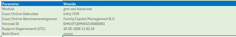

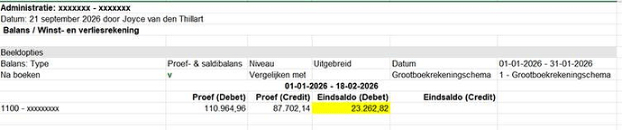

This is the Excel we generated on 18-02 using Get My Report. I only show the ledger I’ve taken as an example now.

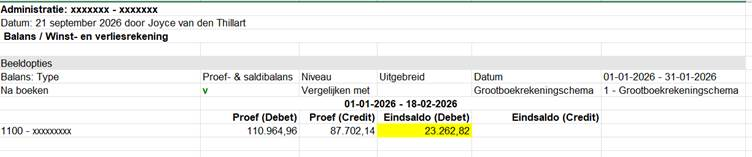

This is the balance in Exact on 31-1 if I print it today.

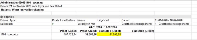

And this was the balance in Exact on 18-02 if I print it today. The transactions between 31-1 and 18-02 all have a processing date before 18-02.
If your theory were correct, the balance on the printout we made on 18-02 would be the same as the Exact balance on 18-02, but this was not the case; this list neatly showed the balance as of 31-01, as it previously did and as we therefore also expected.
