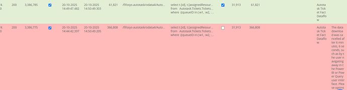

According to system logs, the download has been returning rows at a steady state, delivering 31.913 rows just before the client was detected to have disappeared.

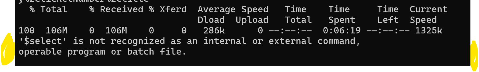

Thank you for the quick response. Curl responded as follows and returned 31,907 rows in 6m19s, comparing to Autotask I do believe this to be all the rows for this query:

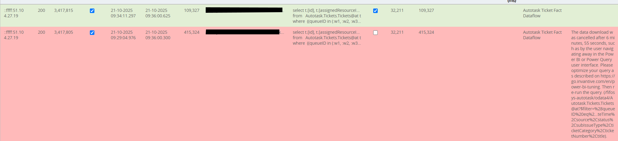

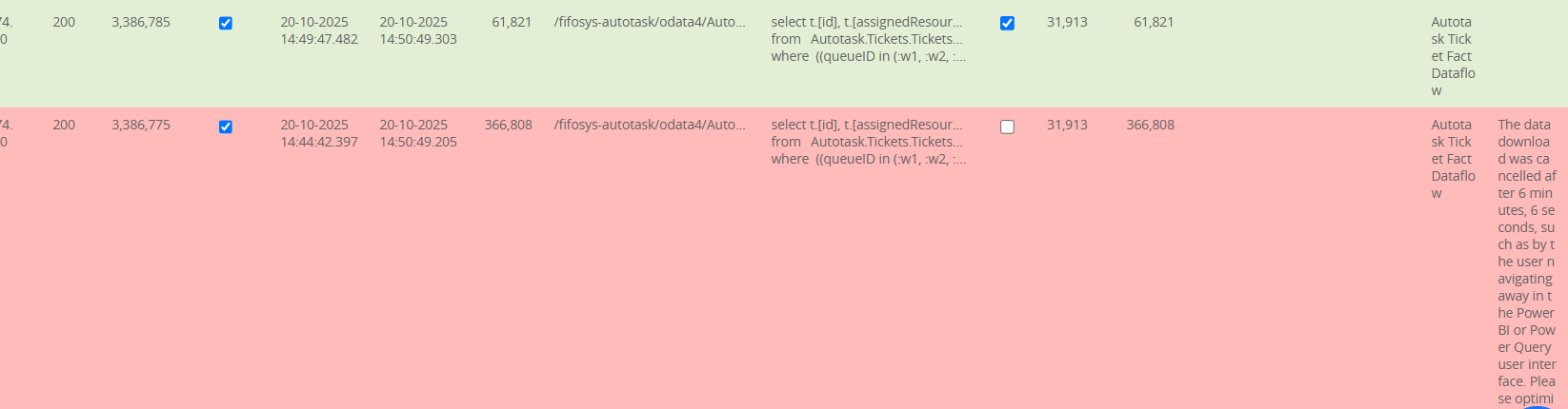

It did come up with an error message at the end (yellow). When comparing to the refresh from the dataflow, the dataflow returned 31,913 rows when it errored, suggesting it returned it all, here is how monitoring online looks from the dataflow refresh:
So bizarrely it looks like the dataflow refresh works but the $select error triggers the failure message in monitoring online
The $select error is probably due to incorrect escaping on the command line and can probably be ignored.

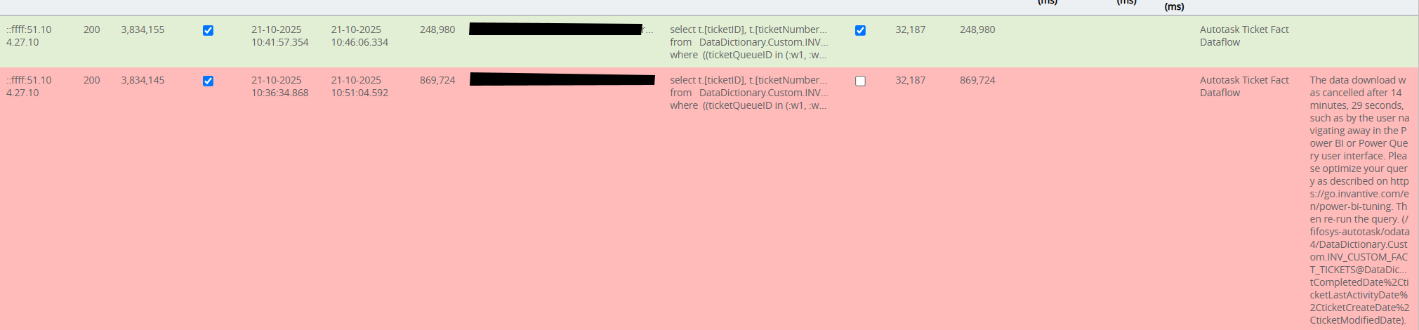

I ran a larger dataset and refreshed from PowerBI … ran for 14 minutes to completion and still the same monitoring online warning:
As it appears to be returning all records despite the monitoring error, I’m not overly concerned.
