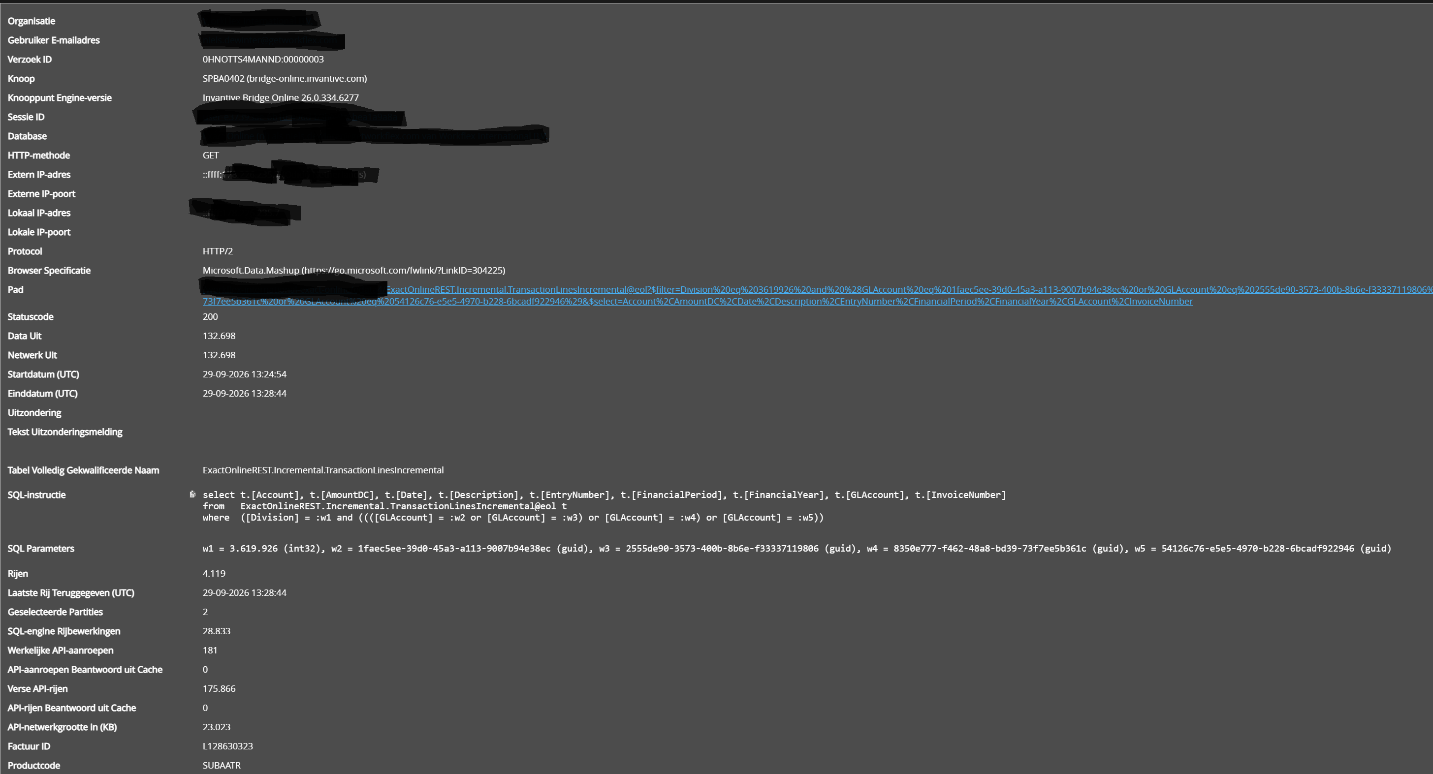

Request ID: 0HNOTTS4MANND:00000003
Here are the screenshots:
Query:
select ...
from   ExactOnlineREST.Incremental.TransactionLinesIncremental@eol
where  (Division = :w1 and ((([GLAccount = :w2 or [GLAccount] = :w3) or [GLOAccount] =:w4) or [GLAccount] = :w5))
Division: 3619926
GL accounts: four different GUIDs
Visible result: 4119 rows.
Processed: 175866 rows freshly retrieved from the Exact Online API, 0 answered from cache, with 181 API calls.
Duration: 230 seconds.
Selected partitions: 2
Version: Invantive Bridge Online 26.0.334.6277
