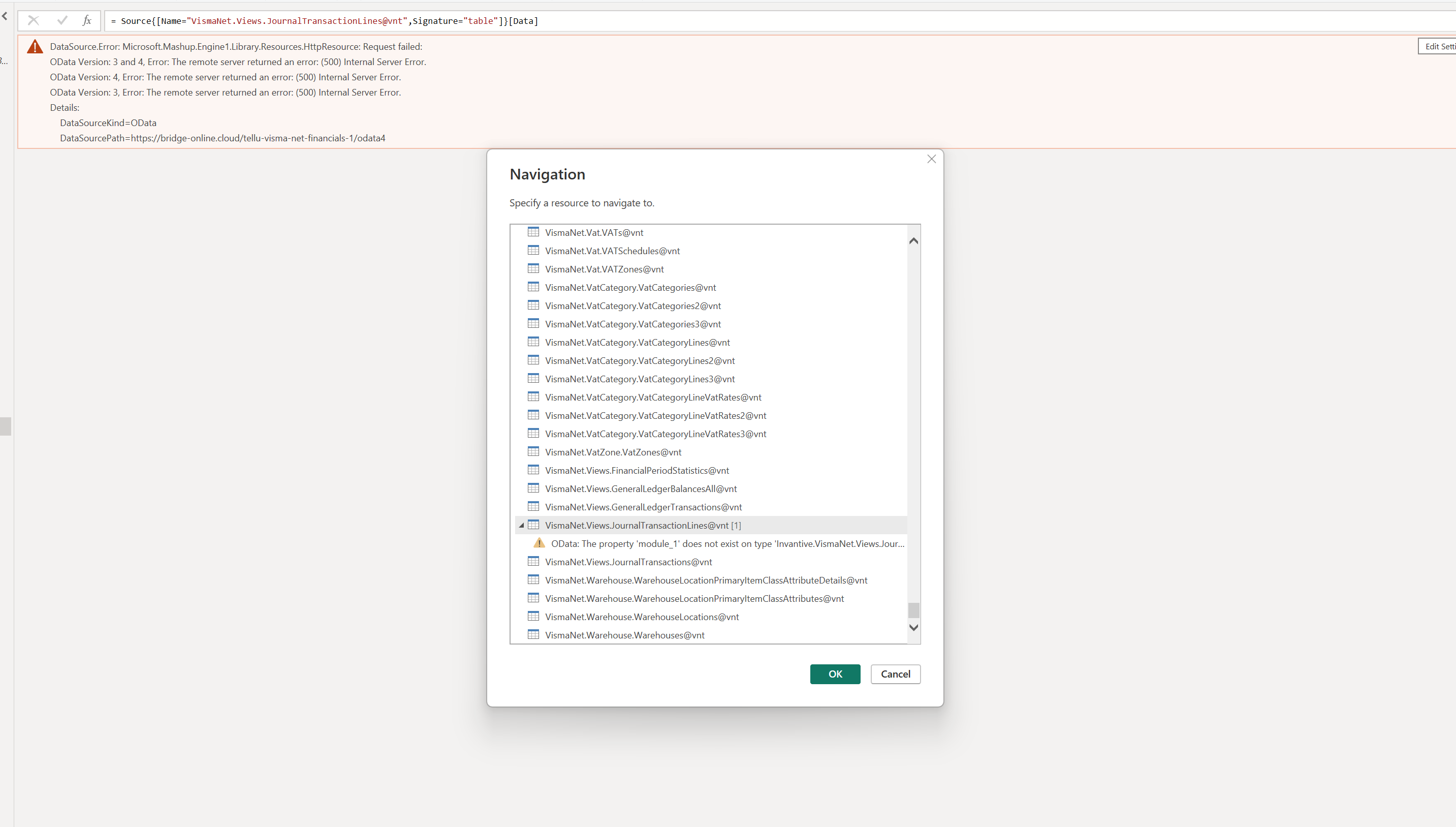

VismaNet.Views.JournalTransactionLines@vnt table not working
Yet another table in Visma stopped to work. After Sales Orders now it is the table JournalTransactionLines.
VismaNet.Views.JournalTransactionLines@vnt appears to have invalid metadata.
Power BI Dataflow refreshes started failing on 15 Oct 2026.
Error:
The property ‘module_1’ does not exist on type ‘Invantive.VismaNet.Views.JournalTransactionLines@vnt’.
In Power BI Desktop a new OData connection can see the entity, but when expanding the Data column no fields are returned and Power BI displays:
No columns were found.
What is the problem?

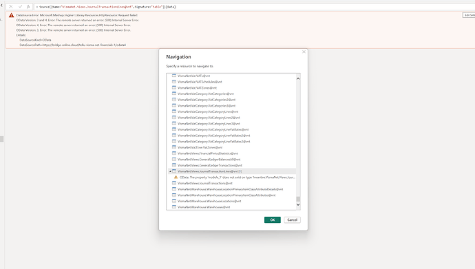

VismaNet.Views.JournalTransactionLines@vnt is still visible in the OData metadata and can be selected. However, Power BI Desktop returns a 500 Internal Server Error on the Navigation step. The Navigator also shows:
The property 'module_1' does not exist on type ...
Could you verify whether the schema for VismaNet.Views.JournalTransactionLines@vnt has changed or if there is an issue with the OData metadata for this entity?
The metadata for the underlying JournalTransactionLinesByPeriodOrDateV2 has changed slightly. There is a module and module_2 column now. Can you change your report to use either of these fields and retry?
